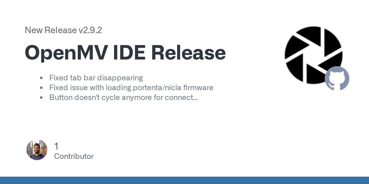

It seems like I need to install some proper driver or maybe downgrade the openmv-ide-mac-2.9.7 to openmv-ide-mac-2.9.2 ?
Hi, please use the previously released version of the IDE. The one we put online as the latest has a sped up bootloader which doesn’t appear to be compatible with some folks machines. I don’t quite know what’s causing the issue however on why it doesn’t it work.
I’ll be building a new IDE release and making that available in the coming weeks. I have a fix for the speed up which is to slow it back down again in the meantime.
I pushed the latest firmware to the previous IDE so it will still give you the latest firmware.
