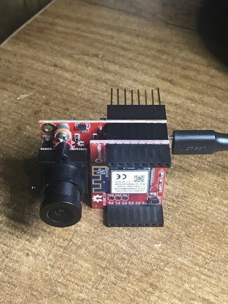

How do you connect the shield ? A photo would help us a lot. And what firmware version do you have on those cameras ?
Will send a photo in a moment.
How do I check FW version, please?
Bottom right corner of the IDE when you connect.
The FW is 3.4.1 - [latest]. Screenshot attached.
Photographs of one assembly are enclosed; i.e. H7+WiFi Shield
Hi, are the connectors on the camera soldered on?
Solved !!!
You are right. Thank you.
In the absence of soldering, the pins don’t ensure proper/slug contact.

Please note when you solder the headers they should look like this:
Ya…
Done.
Thank you.
