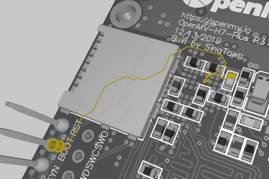

Hmmm, well, it’s not dead, but, BOOT0 must be stuck high for this to happen.
Check this:
The chip has internal flash, so, it will just run the regular bootloader which blinks the green LED if it’s okay.
I don’t understand. What am I supposed to do?
Check if something is keeping it high. If the traces on that signal net are not being pulled high by anything then something is very wrong with the STM32H7 chip onboard.
