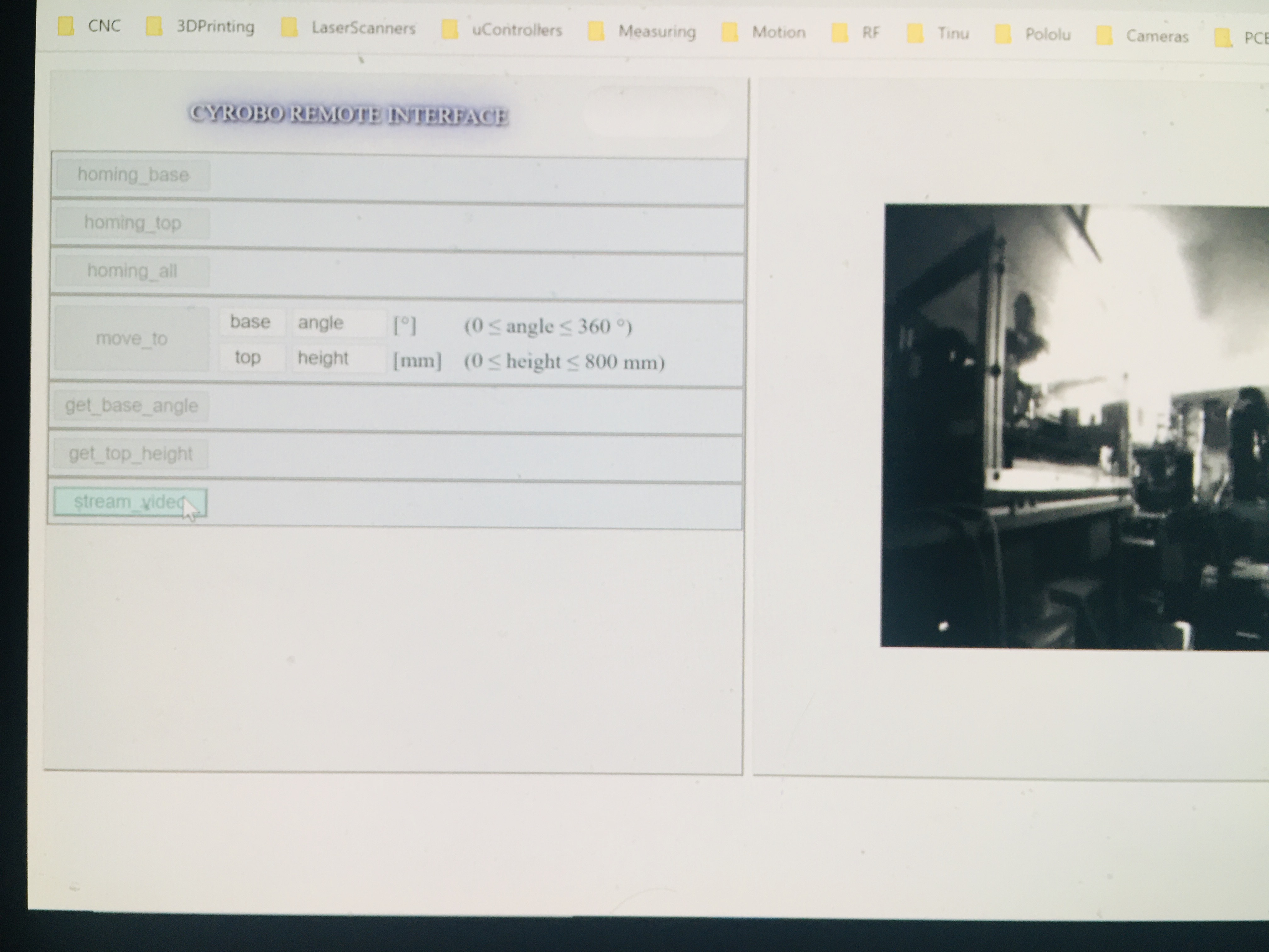

The browser interface looks like
When the button stream_video is pressed then the ajax call is make. After the first press is looking like
then after the second call it freezes
Thank you, I did not see that in in the ticks_diff. I will correct it and try it again. I will try to close the client too.
I tried the two things, it is better now. The second time I get a static image. The problem may have to do with my image tag. After I display the 10 sec stream I remove the image tag from my div. That may not be enough to close the socket on the browser side.

Yes it looks like something with your Ajax code, in the browser I get a static image too but I hit refresh (this probably opens a new socket) and it starts streaming again.
The problem was the image caching. I appended a unique tag at the end of the address based on current time. That seemed to solve the problem. Now everything works as expected.
