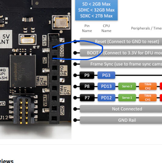

Can you do this? Please attach a wire between BOOT0 and RESET:
Then plug it into the PC. The IDE should help you recover it.

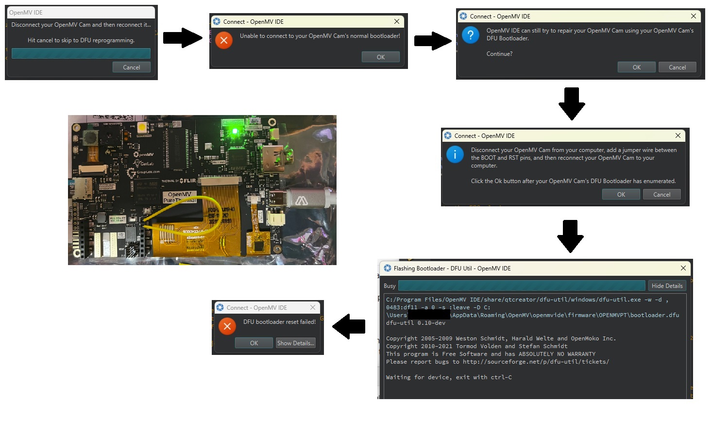

Windows still doesn’t detect the device. If I follow the “brick” prompts in the IDE, it doesn’t seem to help. I’ve attached a pic and the most pertinent screen shots from the IDE (I made a collage as I couldn’t attach more than one picture).
I go through the brick recovery prompts, (including the one that suggests the BOOT & RST jumper) and get to this recovery prompt w/progress bar. It eventually times out. I get an error.
I took some other screen shots at various points during this process. I can upload them if it would help.

You need to contact GroupGets. There’s something wrong with the hardware if BOOT0 connected to VCC doesn’t allow it to reconnect to the bootloader.
