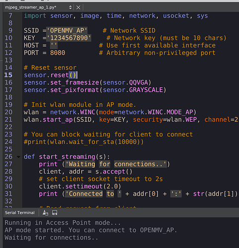

Thanks for the clarification. In my application because I need to initialize the wifi shield in AP mode, this is how I did the initialization which gave me a syntax error.
wlan = network.WINC(mode=network.WINC.MODE_AP)
wlan.start_ap(SSID, key=KEY, security=wlan.WEP, channel=2)
What did I not do right?

I meant when I initialize it in AP mode using the try statement, it gives a syntax error.
This is the code:

When I run this code, these lines of code gives a syntax error
Kindly help me check,

You need to indent these two lines like this:
