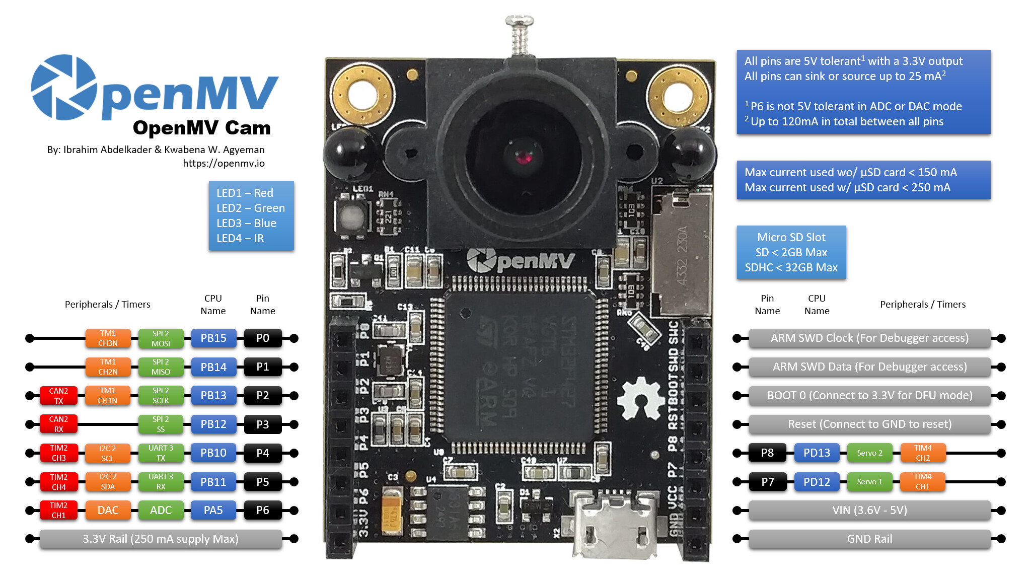

Can I power the OpenMV Cam with a 3.7V Lithium Ion Polymer Battery (https://www.adafruit.com/products/1578)?
And, does the above mean that I cannot charge the battery using the usb connector on the current OpenMV board, but that will be a future capability?
Yes, you can use a 3.7V battery to power the system. Please apply it to the VIN pin to go into the regular. The system cannot charge the battery however. We don’t have a battery charging circuit on board. This is something I’d like to do in the future. The goal for the M7 board was not to break the design and to be conservative as possible.
Do you mean the VCC pin next to the P7 pin?
Yes.
