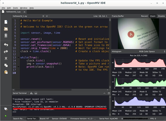

Are you sure you’re uploading the right firmware ? Is it just this one camera or all of them ? The terminal window should show something like this:
MicroPython: v1.17-omv-r1 OpenMV: v4.1.3 HAL: v1.9.0 BOARD: OPENMV4P-STM32H743

Please run helloworld.py, then stop the script and take a screenshot of the IDE and post it.
Please check the version of your camera. Another user had this exact same issue:
import omv
print(omv.arch())
It should say: OMV4P H7 32768 SDRAM
If it says something else the wrong firmware was loaded onto it at the factory. SingTown messed up some units last year and loaded the wrong firmware. You can manually fix using the IDE Run Bootloader feature.
