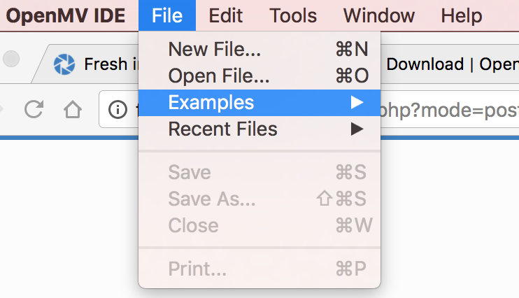

Hello, I am trying to use the OpenMV IDE on MacOS, at first everything was correct but for some reason I do not know it will not let me enter the examples, always show a new version of IDE and it will not allow me to update the firmware of the camera. I have tried to download the IDE again and reinstall it, but it does not work.
I attach some images so they can see what happens.
Thanks!

I checked if the examples in the “app” are the examples and if they appear, also the firmware appears, it is as if the application did not have access to the resources.

We just switched servers. Will debug. The IDE is likely getting an error page and parsing it like a valid response.

Hi, the issue is fixed. The version 4.3.0 was coming from an error page the IDE was parsing. I’ll make the parsing error handling better for v1.8.0.
As for if you accidentally upagraded… delete you “AppData/Romaing/OpenMV IDE” settings folder… or on mac/linux “.config/OpenMV IDE”. OpenMV IDE will then reload the default settings.
