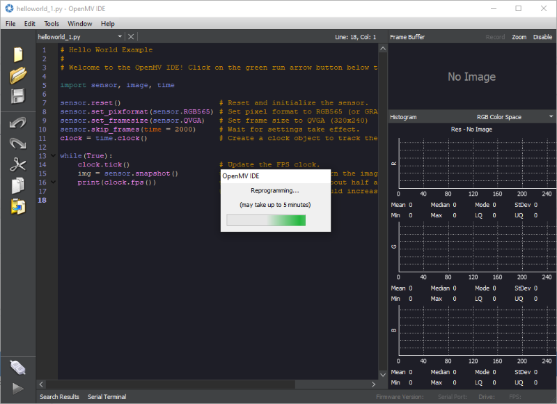

Assuming the cable is working, however, I have attempted recovery with DFU. As instructed I jumped the boot and reset pins but nothing happened. I have attached a picture of my device manager with the OpenMV connected while the pins are jumped. I don’t see anything referring to an ST board but I may be looking in the wrong place.
Next, I opened IDE and attempted to connect to the OpenMV. Followed the procedure to reprogram with DFU. I made it to this screen:
I have let this process go for up to 30 minutes and never observed any change.
