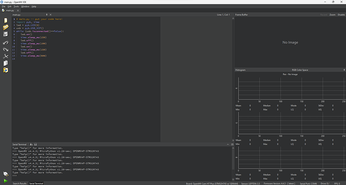

at removable disk(E:) the main.py, readme and openmv_disk file is presented . I tried openmv ide software and clicked to run it showing Run time error: sensor control failed. how to solve this problem? using open mv cam h7 plus. how to start working and installing drivers or libraries?
how to mount internal drive files. in E drive only main.py, readme, and openmv_disk is there but if i click on run it is not running. ide version:4.0.1, firmware version: 4.4.3, board: openmv cam h7 plus stm32h743 w/sdram os:windows
As mentioned on github… if you see:
It means the sensor is not found by the camera. Please make sure the sensor is mounted firmly. Or contact who made that camera. We have not been selling the H7 Plus for a while.
I don’t understand your issue here… you run the main.py file in OpenMV IDE. If you try to run that from the OS it will try to execute the python file via CPython on your desktop which will do nothing.
i tried to run main.py file in openmv ide and clicked on run button but it is not running the program.
openmv ide downloaded from: openmv-ide-windows-4.09.1 , i tried running openmv ide software for flir lepton 3.5 openmv can h7 plus.
The default main.py script just blinks an LED. It is running.
