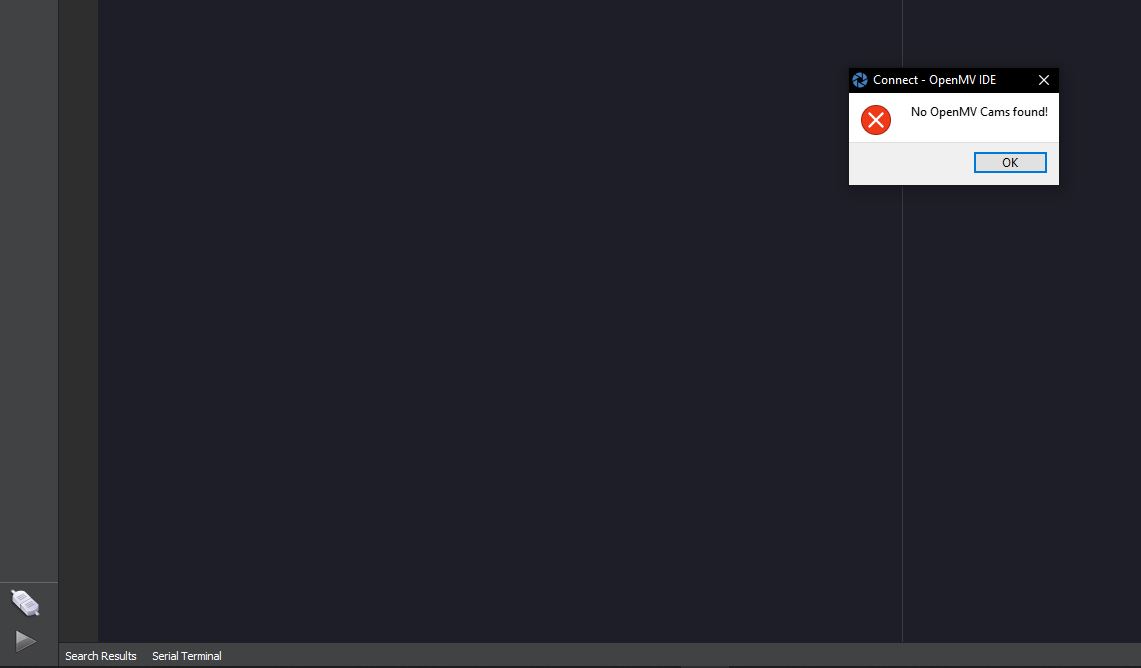

  • “Click the connect button while the Cam is not connected to the PC. The IDE will then ask you if you have a bricked OpenMV Cam. Say, yes, then select if you want to erase the flash drive or not. Doesn’t matter. Then the IDE will wait for you to connect the Cam to your computer. Do that. The boot loader will not overwrite the cam.” (It just times out)
  • Saying “yes” to if I have a bricked board and selecting OpenMV Cam H7 and following the instructions. (It, again, just times out)

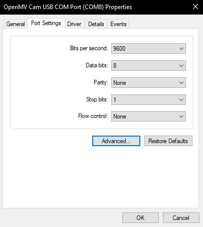

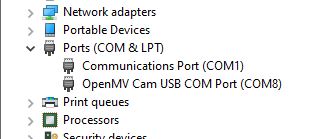

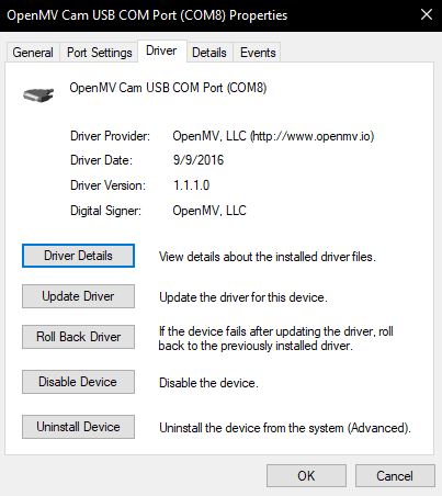

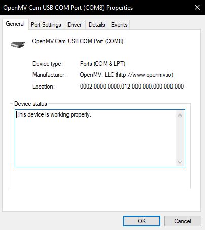

What does it appear as? The IDE is looking for a COM port. Does one showup when it’s plugged in? What type of device does it appear as? If it’s just a generic USB device then the driver must be missing. The IDE should have installed this for you.
See Images:
OpenMV H7 Cam Showing In Windows Device Manager
OpenMV H7 General In Windows Device Manager
OpenMV H7 Driver In Windows Device Manager
OpenMV H7 Port Settings In Windows Device Manager
Mmm…
That is weird.

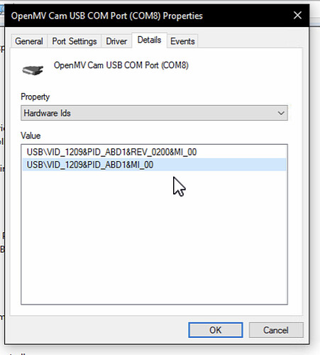

Okay, the only reason for this is that the IDE is filtering for a specific PID/VID on the serial port.
Can you post the PID / VID of the serial port? It’s in the device details.
The driver bound to it though… which is PID/VID controlled.
Only other thing I can think of is that there’s something wrong with the main firmware.

See image:
Are you talking about this: because it just timed out when I tried this:
Yeah, that the right PID/VID.
I’m kinda stumped. It’s clearly connected to your PC and has the right PID/VID. But, the IDE can’t find the serial port.

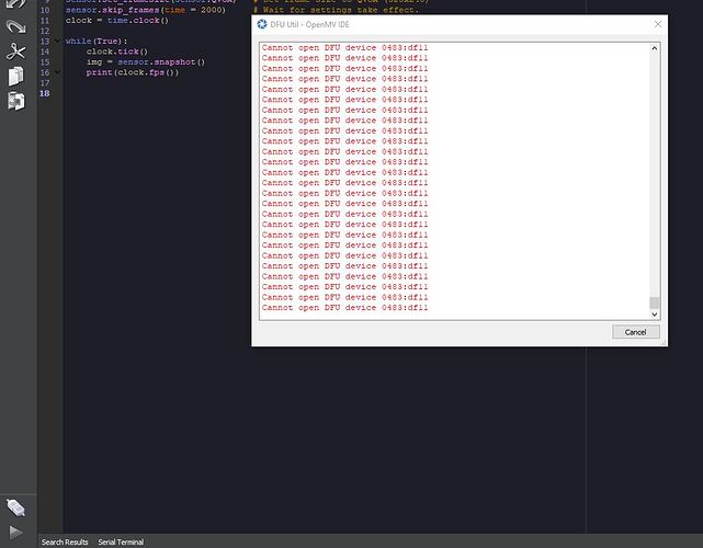

The only thing I can think of is to reset the board via the DFU bootloader. Please follow the above steps again, then click cancel when the IDE is trying to connect to the board. It will then ask if you want to try the DFU bootloader. Say yes, follow the steps. The DFU bootloader is via DFU-Util which is a third party tool. It will update the firmware and things should work. If not… then I’m not sure what’s wrong.
Here is the result of Resetting the board via the DFU bootloader: :expressionless:
At this point are you interested in me mailing it to you to have a look at it yourself?
