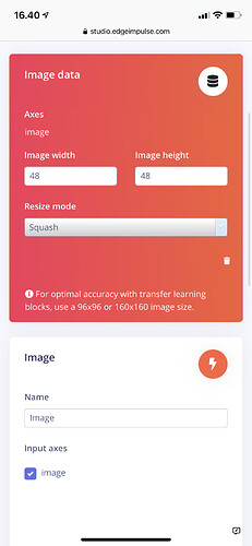

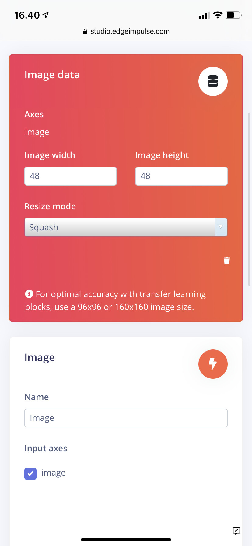

Currently I have the following set in EI
Image - 48x48
Transfer Learning
Color depth - grayscale
Neutral network architecture
- here I have tried different types, but most of them takes up a lot of memory
Currently I have a MobileNetV1 0.1 selected, but it performs very bad in accuracy

As I mentioned before, in Edge Impulse go to the Image input and set the size to 48x48 pixels. This will significantly shrink the network size. You don’t need to change anything else.
