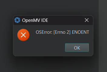

I was using a 16gb MicroSD card to load i model for image classifcation :
but, i try one code to search the MicroSD card to see the files :
print(os.listdir("/sd")) # Lista os arquivos dentro do microSD
But, this error appears :
can someone help me to solve this problem ?
Hi, the folder name is “/sdcard”.
Your OpenMV Cam with the latest firmware runs this on startup: openmv/scripts/libraries/_boot.py at master · openmv/openmv

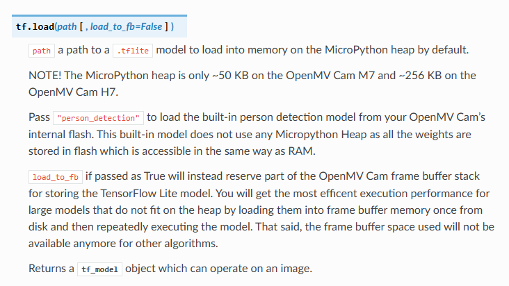

net = tf.load("trained.tflite", load_to_fb=True) # load_to_fb=True pode ajudar para modelos grandes
On the forum, it says that the command exists, but the error says it doesn’t? I made the model using edge impulse
Hi, we removed that module last year.
Please see the porting guide:
