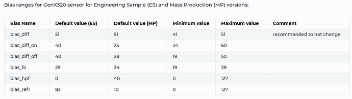

Not clear if you want to remove the flicker or see only the flicker(high frequency) ? You can actually tune the sensor to see only the range of frequencies using bias_hpf (defines from which frequency you can see) and bias_fo (defines up to which frequency you can see). Some more details on biases tuning are available here Biases — Metavision SDK Docs 5.1.1 documentation
There is also AFK (AntiFlicker filtering) where you can specify a range of frequencies to filter but it is less performant comparing to bias settings (less advantageous for the sensor readout).
This is also documented in Biases — Metavision SDK Docs 5.1.1.
I would like to adjust individual bias parameters—bias_diff_on, bias_diff_off, bias_fo, bias_hpf, or bias_refr—to better match my LED’s flicker characteristics.
In OpenMV, how do I tweak one bias register at a time? Is there an ioctl call that lets me set just a single bias?
See the docs:
E.g. csi0.ioctl(csi.IOCTL_GENX320_SET_BIAS, csi.GENX320_BIAS_FO, number)
