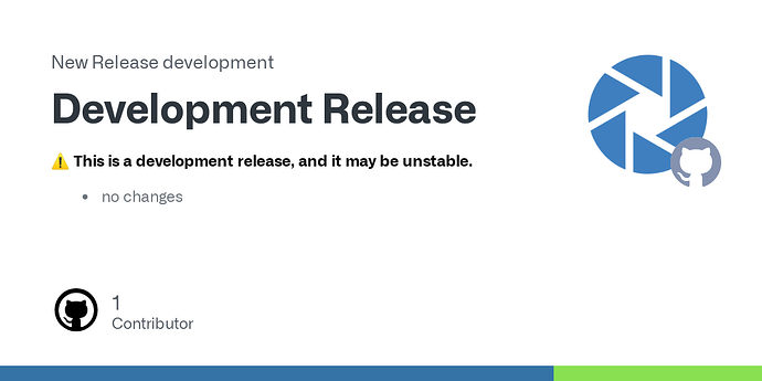

Hi, can you try the latest IDE which now works with our new bootloader on windows?
Install the non-factory version.
There was an issue with the DFU drivers that I’ve resolved. It will now bootload correctly on windows.
This isn’t the final IDE release. But, getting close to having it ready.
