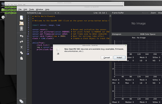

Which distribution are you using ? And can you attach some screenshots ?
Hi,
I use Linux Mint 20.1 Mate 64bit.
This is what I see:
8-Dale
I tested it with a fresh linuxmint-20.1-mate-64bit install and it seems to be working fine, tried 1, 1.5 and 2 you can see the menus, buttons and text inside the app get bigger. The window title and decorations seem to be globally set.
QT_SCALE_FACTOR=1.0
QT_SCALE_FACTOR=1.5:
QT_SCALE_FACTOR=2.0:
OK. When I set QT_SCALE_FACTOR, everything is affected, including text in the code window. I do not want the text in the code window to be affected. As you can see in the attached screenshot, It makes the code window text HUGE, which is unusable. I have to set QT_SCALE_FACTOR=3.0 to get the menus to where I can read them without straining my eyes.
8-Dale
In the text editor press ctrl and “-” will zoom out.
Ah, OK! That works and leaves the menus and such large enough that I can still read them.

OK, I have a way to make this work now. I have the openmvide in my PATH and I created a small script:
`#!/bin/bash
QT_SCALE_FACTOR=3 openmvide`
This works! :slight_smile: Sorry for the problems,
