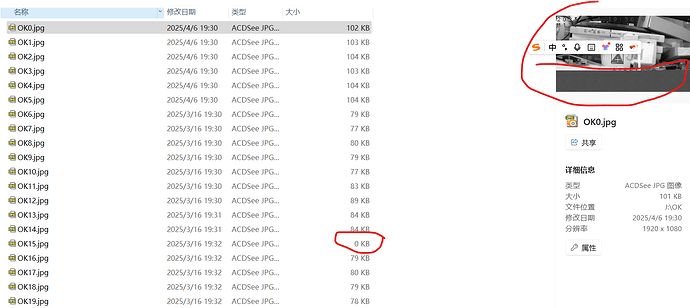

some picture can’t saved,and some picture was saved in half.
what wrong?
This looks like some type of bug. A 0KB file is a file save issue. FATFS is pretty well debugged though… was there a system crash then?
As for the line in half of the image. That looks like JPEG corruption. How are the JPEG images created?
