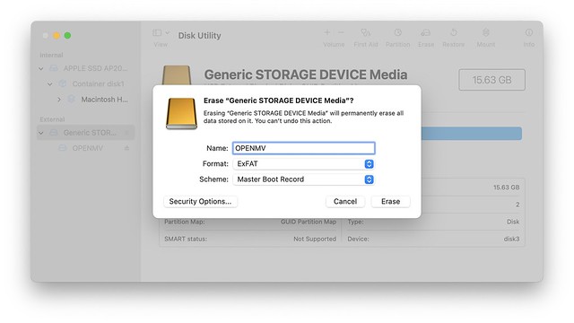

OK, after further investigation I guess it was my sloppy formatting that caused the issue. MacOS Diskutil shows two entries for a single SD card. Seems to be important to select the “Generic STORAGE DEVICE Media” one (not its child entry) and select “Master Boot Record” in addition to “ExFAT”. Anyway, now both (Kingston 16 GB) cards work fine with the cam.

The marked solution doesnt work for me. I have a new H7 plus cam and tried 4 different SD cards. I also tried different formating programs on windows (the standart one, rufus, the one from sdcard. org mentioned here). I also tried different formats (exFAT and FAT32) and even got a mac and tried with the exact same settings as shown in the screenshot above.
