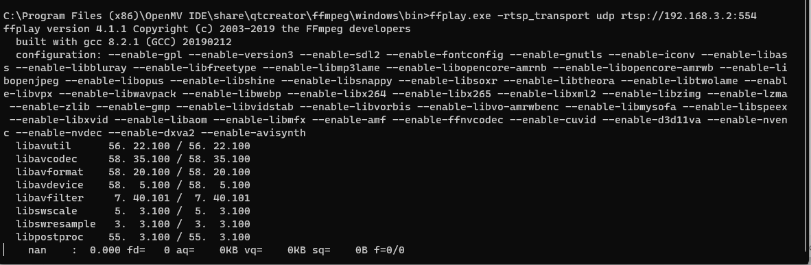

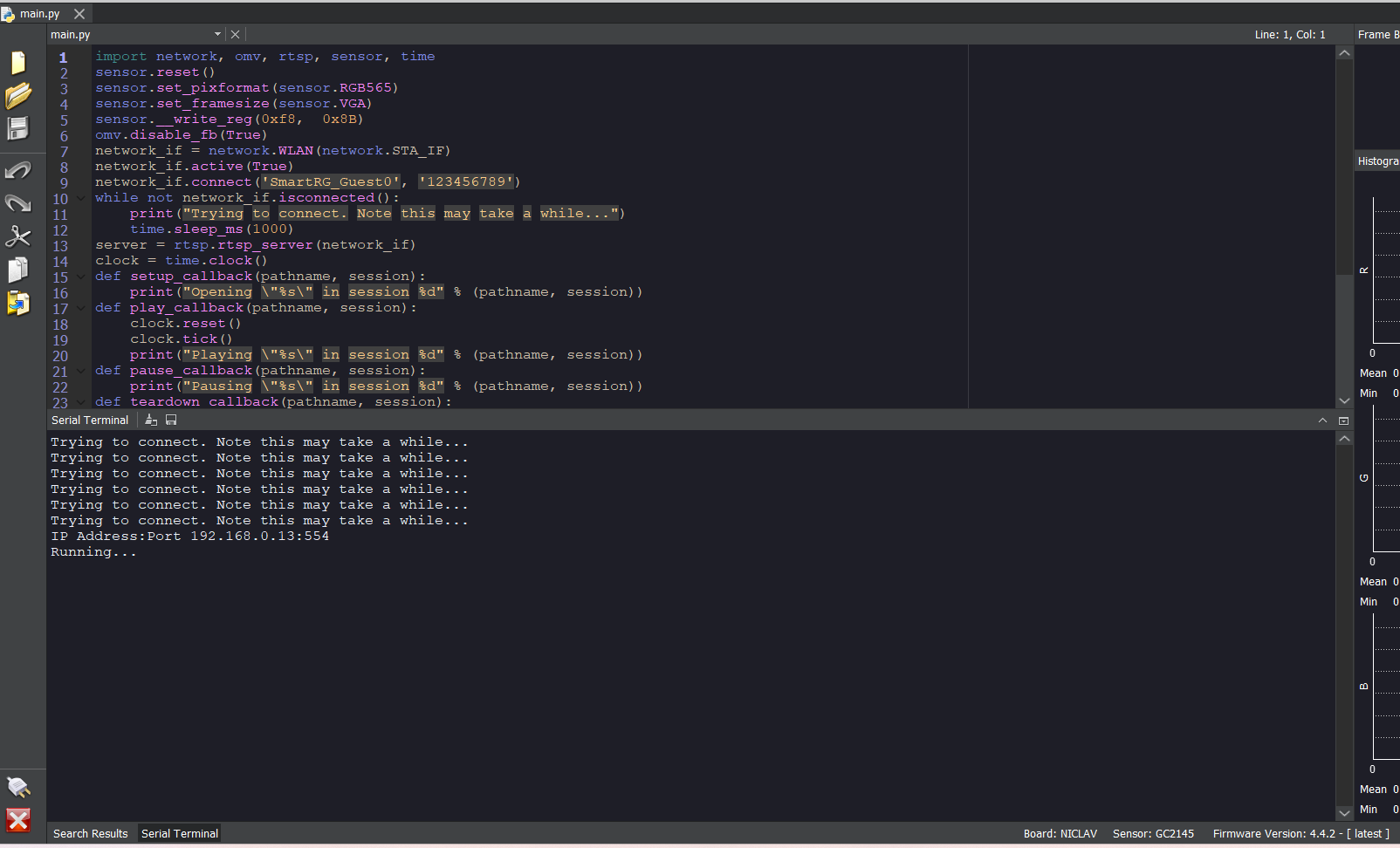

Hi, I would appreciate if someone can help me. Am I missing something? Firmware version 4.4.2. I got the IP 192.168.3.2:554, but I can’t visualize it. I’m using ffplay.

ffplay.exe -rtsp_transport udp rtsp://192.168.3.2:554

Hi, you have to run an example script on the camera. The libraries just run on the camera.

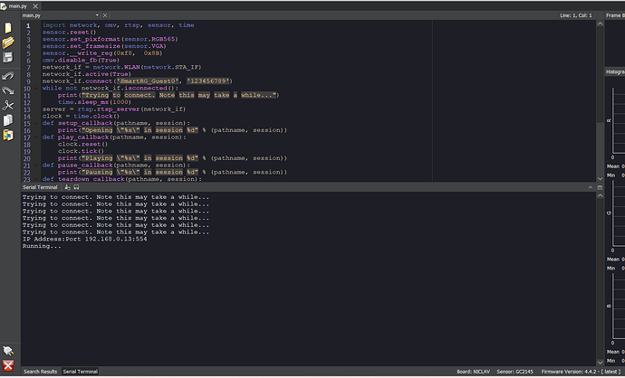

Hi @kwagyeman, Could you explain that to me please? I have the example script on the camera.
Okay, does that example script connect to the internet and have a DHCP address? And then did you point ffmpeg to that IP address printed?
From the previous post it looks like you are doing the right thing.

yes, I do.
Scrip connect to the internet

Okay, at a minimum you should see packets from FFMEG trying to ping the camera on wireshark. Even if the camera doesn’t respond.
Please remove the port number from the ffmpeg command. However, it appears the issue is that ffmpeg doesn’t send any packets to the camera. When you run the ffmpeg command you should see it send a TCP SYN packet to the camera IP address at a minimum.

Please add an IP address filter to your wireshark session for the camera.
You should clearly see FFPLAY send packets to the camera IP address.
