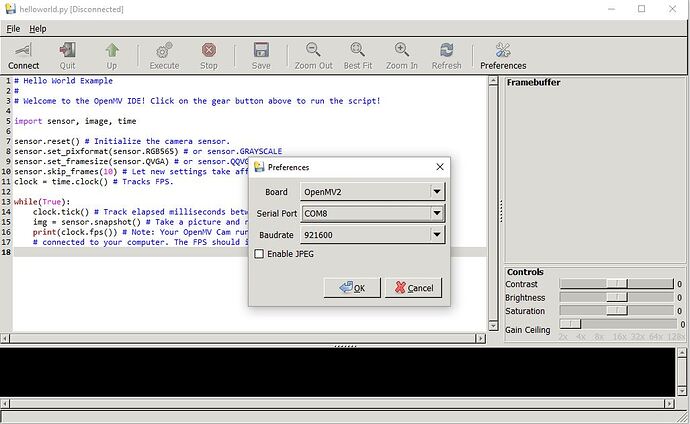

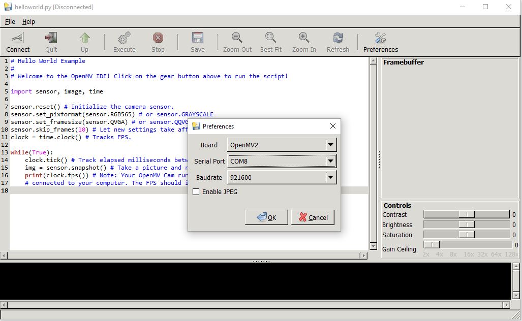

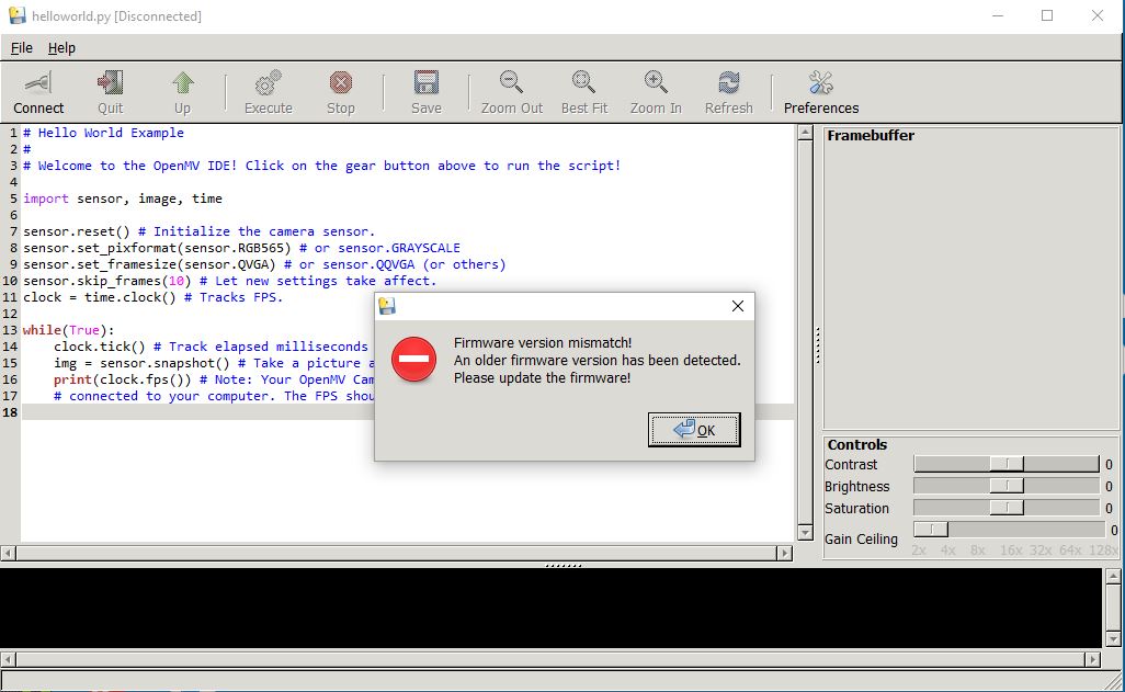

Just to note, that there is no physical issue or hard fault with the board - I get a flashing blue “heartbeat”. When I try to connect, after verifying that I have selected the correct COM port, baud rate and board type, the IDE presents the following error message:

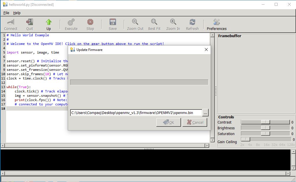

So I proceed to use the built-in firmware upload utility. It (and preferences) are the only two available options, as the rest are grayed out.

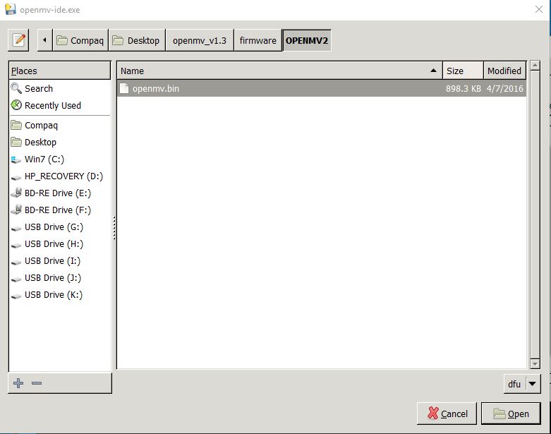

For some odd reason, the firmware update utility doesn’t like .DFU files, and instead, only accepts .bin files. The utility clearly points out the .DFU file extension selection option at the bottom. I went ahead and hit ‘open’, and when I hit ‘OK’, the IDE did nothing but hang.
