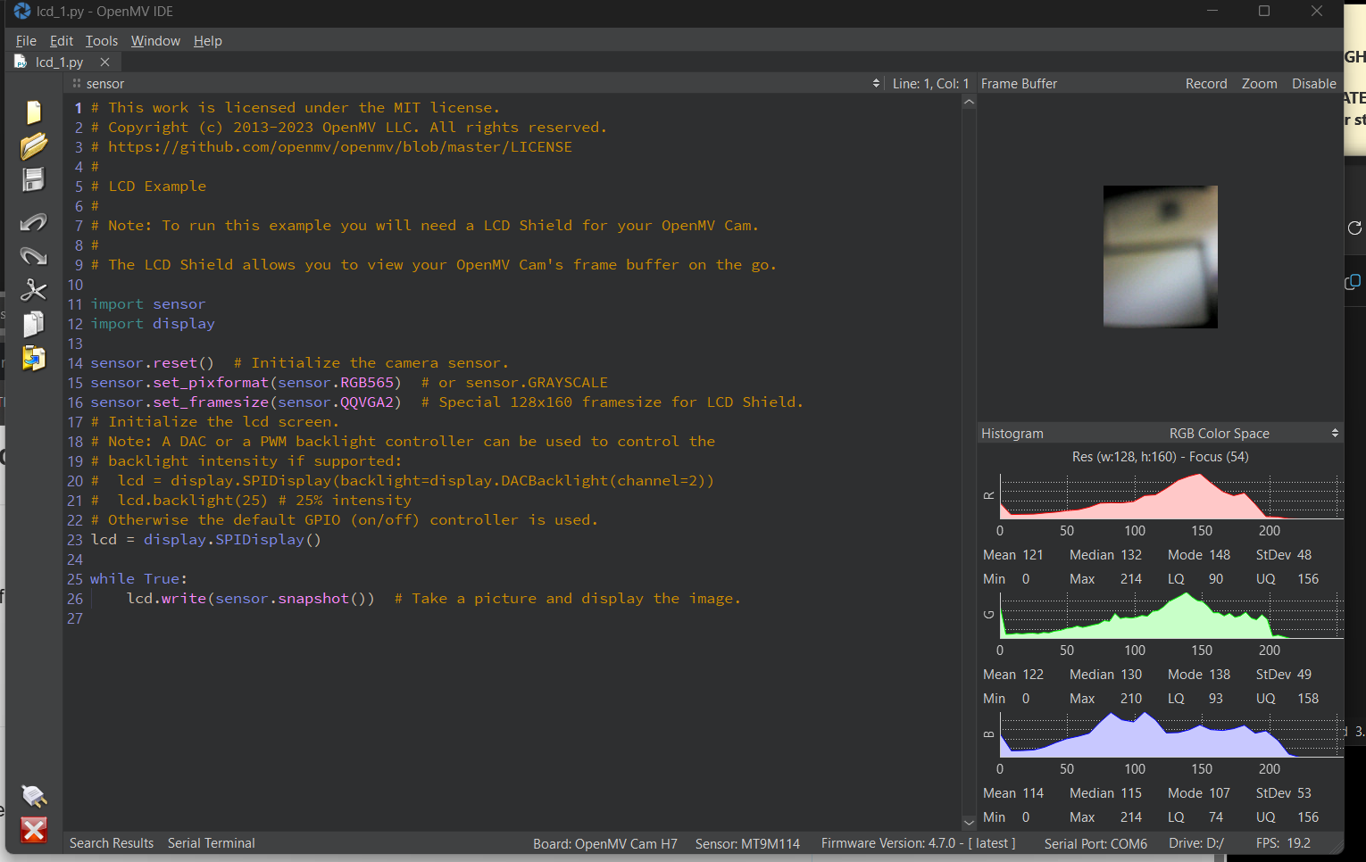

The camera’s image will display fine in the IDE but no image will show on the LCD just a blank white screen. (It looks like the LCD screen is just receiving power and no data from the camera).

Yes the script was running, and the IDE was showing the snapshots were happening, just nothing was being displayed on the LCD. (The snapshots were being sent to the LCD).
