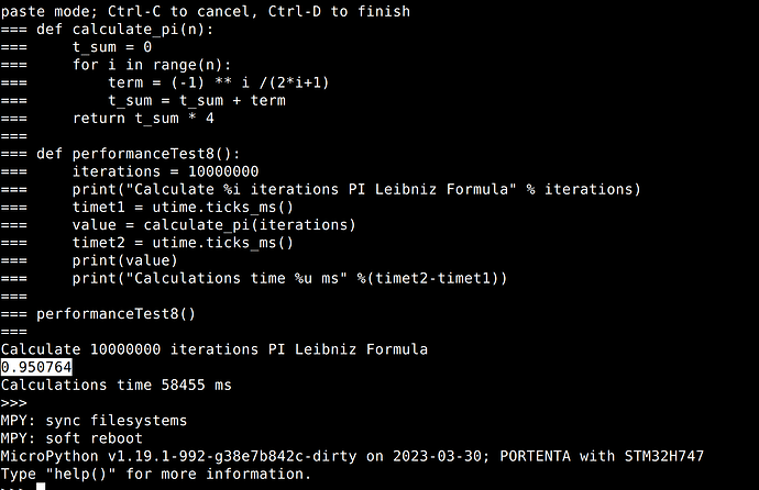

Found erroneous behavior in floating point calculations in openmv firmware when doing a performance calculation test.
A very simple procedure for calculating the number pi using the Leibniz formula, 10_000_000 iterations.

Got the following results:
OpenMV Cam H7 Plus (omv):
0.950764 !? !? !? !!!
Calculations time 48205 ms
Portenta H7 (omv)
Calculations time 57519 ms

All platform versions from OpenMV give an error, except for Arduino BLE33Sense (omv):
3.141597 !!!
Calculations time 517730 ms
Please fix it, otherwise there is an uncertain impression of the calculations.
