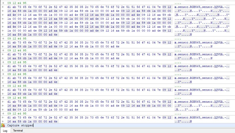

Hello,
on H7 side I save image_transfer_jpg_as_the_remote_device_for_your_computer.py as main.py
unfortunatelly, MV cam reset from IDE does not work causing IDE freeze, but I do verify that main.py exists
on virtual disk and has correct content.
Then I reboot MV cam manually and launch on PC
python -u rpc_image_transfer_jpg_as_the_controller_device.py from **openmv-master\tools\rpc**.
The SW find MV cam serial port, but produce nothing.
I attach serial traffic snapshot.
Whjat is wrong?

If I set OMV side to 115200 I got as attached pics results.
In other words, the result is the same as in my first attempt with usb vcp on OMV side.
