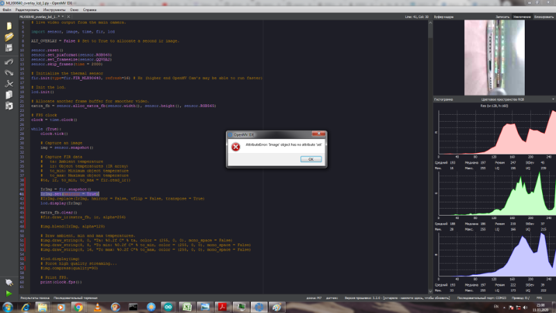

Hello! I use the MLX90640 sensor to my OpenMV and get a reflected thermal image. I use the standard example MLX90640_overlay.py from OpenMV IDE. How to mirror horizontally the image from the MLX90640 sensor?
Use the snapshot() method to get the thermal image from the sensor. Then use set(h_mirror=True) to mirror the image and then use the draw_image() method to overlay the image using an alpha blend.
Update your firmware.
