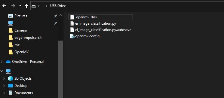

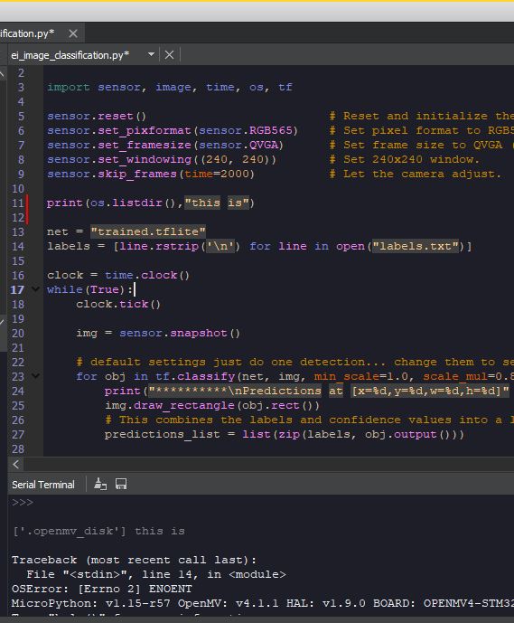

Hi, I also have this error, but when I execute this code you said
Import os
Print (os.listdir ())
Prints only .openmv_disk and does not print the rest of the contents of the memory. What should I do?

Can you verify the file was written to disk? Flush safety remove the disk.
