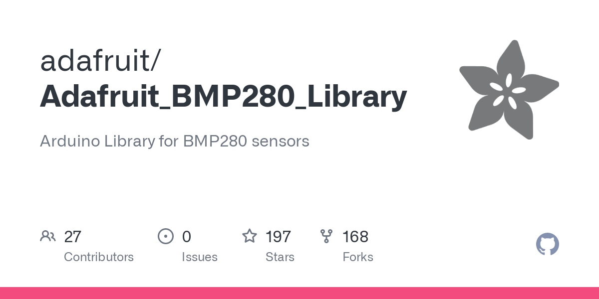

Recently in order to read data from the Adafruit BMP280 sensor with i2c communication, I used the provided Adafruit_BMP280.h library and uploaded their Arduino code to ESP32 which worked;
Sensor Library:
Sample Code;
