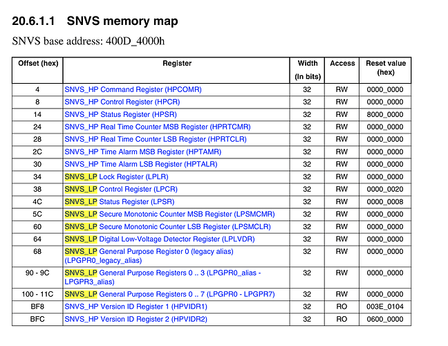

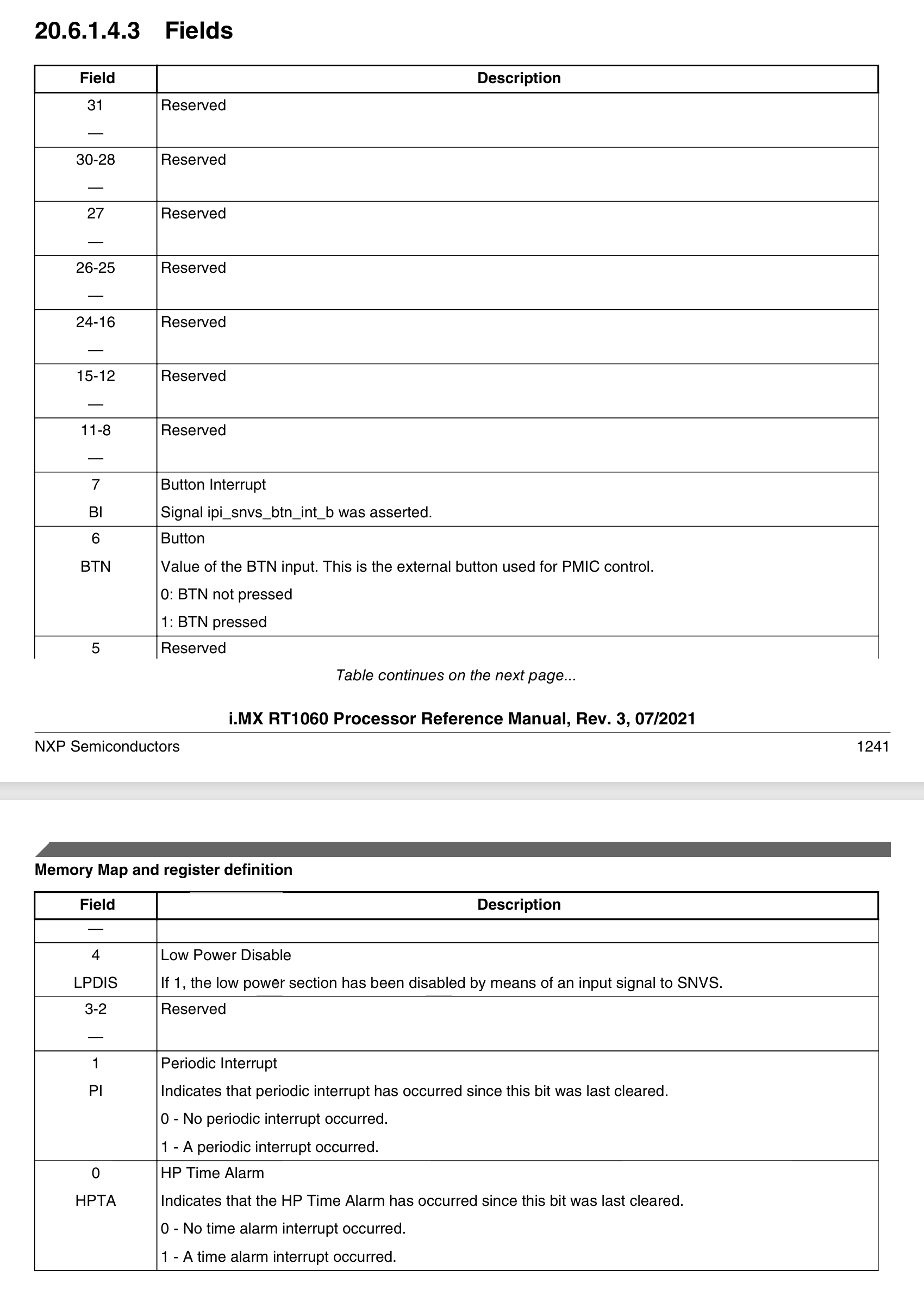

Is there a way to read the value of the Power On/Off pin on the RT1062? I’m looking for a way to use the 5 seconds while the Power On/Off pin is held low to shutdown my app gracefully.
Read chapter 20 in the reference manual for all the cool stuff you have access too. There’s 32-bytes of RAM that keeps it state on power off too.
