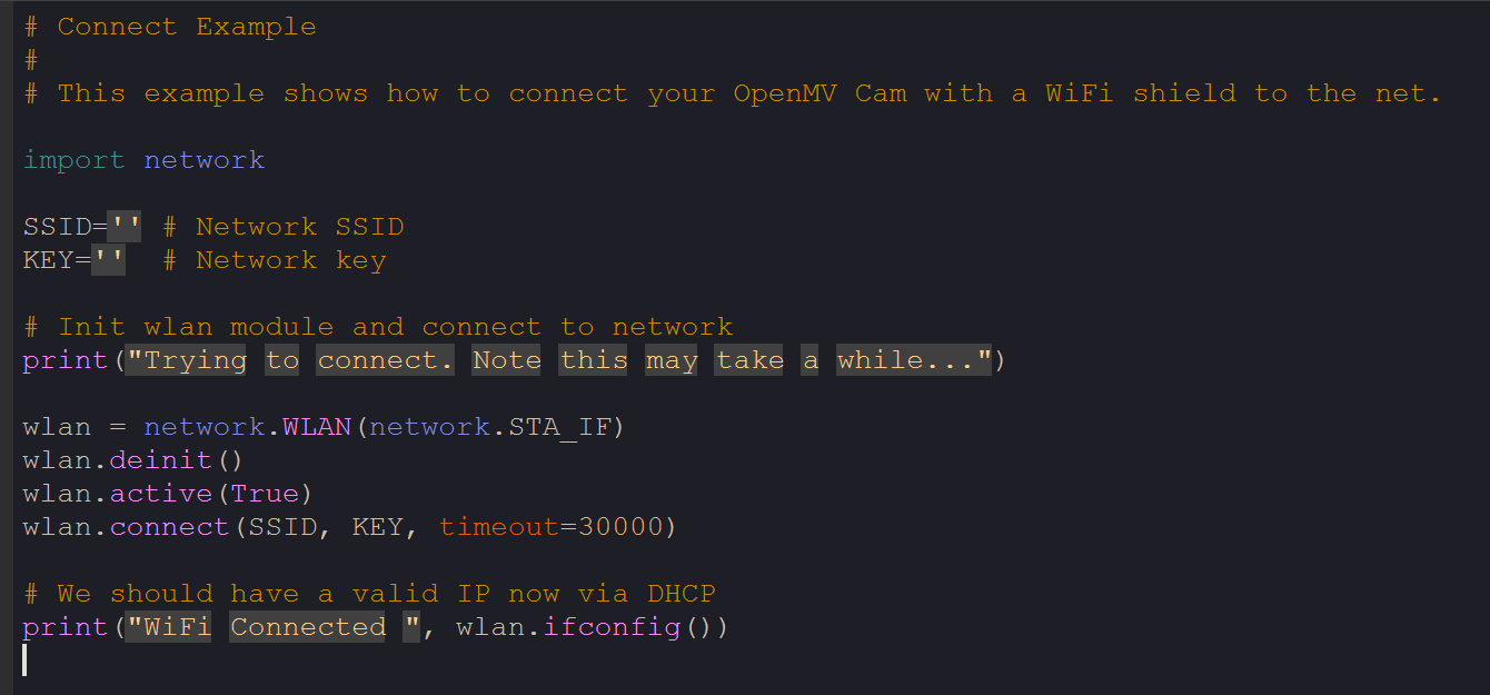

I have already deployed image classificaiton model (edge impulse model )in Nicla Vision and want to send the data I connect (string label and integer locaiton) through. Using the example for wifi connection, the board is connected. Now I can I send the data through wifi after it is connected?
Using the example MJPG streaming, I can see the video. But how to upload string and integer to the client website? Could you give me an example.
