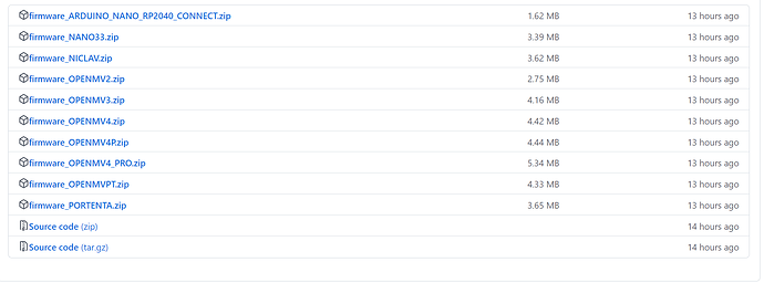

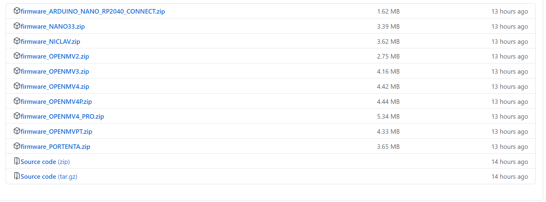

Yes, try the latest development firmware, it should be fixed now.
Hi @iabdalkader ,
Could you please confirm which firmware to use for “OpenMV H7 Plus”?
That would be the OPENMV4P
Thank You @iabdalkader. I will try it out.:slightly_smiling_face:
