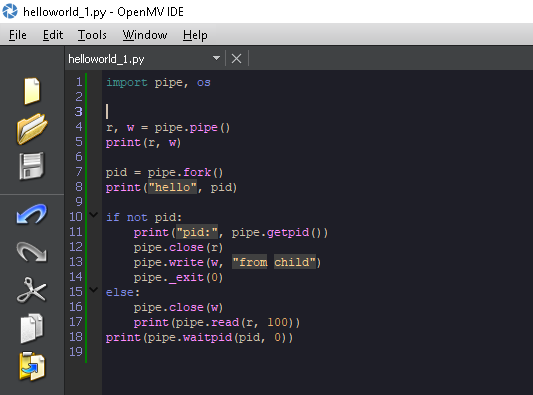

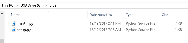

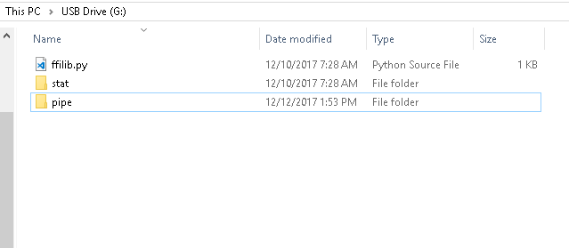

Here are some screenshots to show my setup I changed according to your procedures but I still get same error:

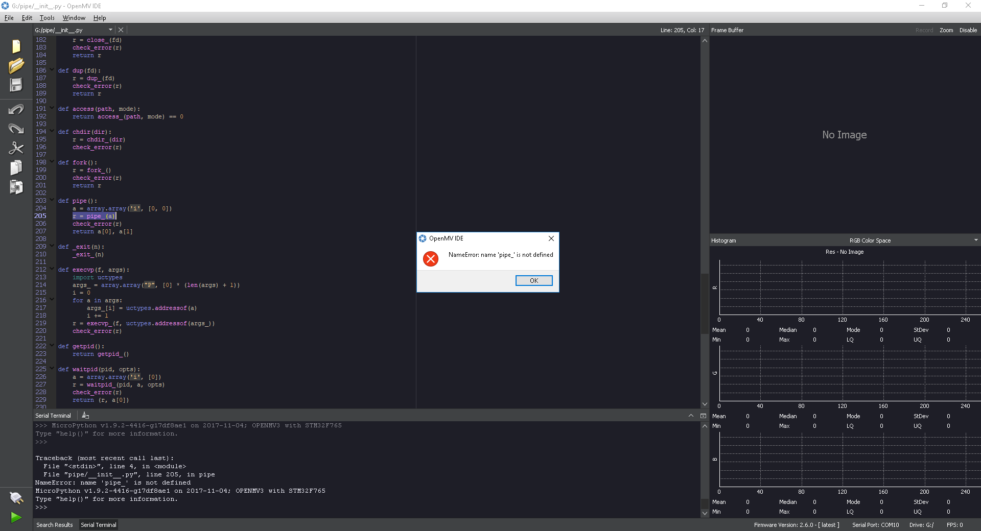

After running the code above, I get this error from the init.py module

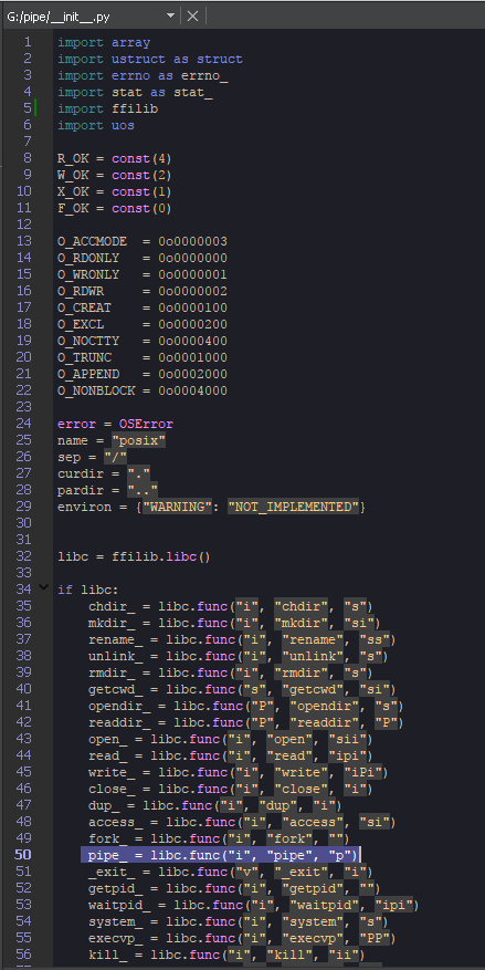

Here is the module I am looking to import:
https://github.com/micropython/micropython-lib/tree/master/os/os
Do I have to import the whole “micropython-lib” library for it to work so that “/os/init.py” can work since it imports other files into its own module?

That’s because there’s no libc to load, there are no FDs and there’s only a single process running anyway. The camera runs baremetal (it’s Not Unix/Linux based).
Oh okay I see. I am sorry I didn’t make that connection before.
Thank you for such a quick reply.

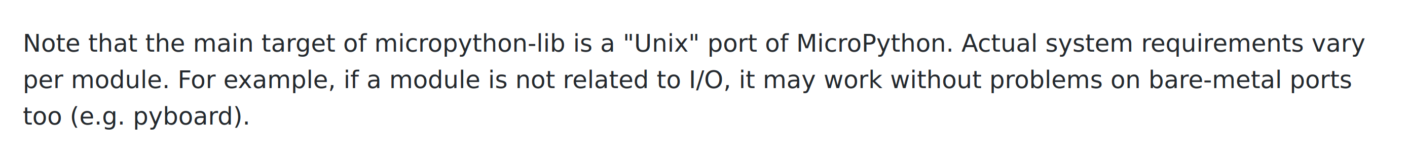

Oh, yeah, alot of the MPlib stuff is for the unix port of MicroPython.
