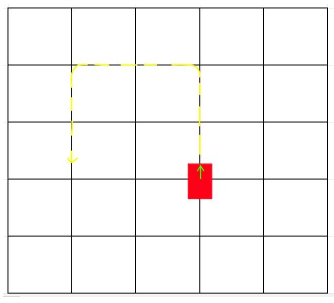

I’m building a robot to move in a well defined matrix by following perpendicular lines.
I can navigate very reliable over one line using get_regression, but I also need to detect when a perpendicular line is coming to localize and turn the robot on the correct line. I’ve attached a picture of this.
Can anyone tell me what would the most efficient way to detect these two lines?

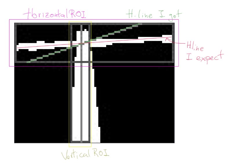

Here is an example of what I’m getting.
I would expect the horizontal line to be follow a lot more the white line but I can’t get it to do it at all.
Maybe my strategy here is wrong and I should be using some other function?
I have tried using find_lines and find_line_segments but they produce much more unreliable results… or most likely, I haven’t got to set the parameters well enough, I guess.
Any idea how I could improve this detection?

Mmm, do this. Zero the roi at the top of the image. I.e draw a black rectangle in the area where you see the center of the vertical line at the top. This will remove that.
You should use the vertical line center to dynamically move the rectangle center.
hmmm… interesting approach!
So I’m doing
        img.draw_rectangle((previousROIvertical[0]-3, previousROIvertical[1],previousROIvertical[2]+6, previousROIvertical[3]), color=0, fill=True)
Once I’m done with the vertical line, I’m making the rectangle a bit bigger than the ROI so I’m sure I don’t leave any white spots there.
Still, the get_regression seems to like getting more vertical than horizontal lines.
Is there anything I may be missing?
Here are a couple screenshots.
That’s definitely not expected behavior.
Upload a pic of the unmodified image and I’ll fix your code.

And here a couple more examples of the before and after images:
I really appreciate your help looking into this!
Seems like something is wrong with robust linear regression. It gets the answer wrong with the horizontal line.
BINARY_VIEW = True
GRAYSCALE_THRESHOLD = (200, 255)
MAG_THRESHOLD = 12
MAG_THRESHOLD_HORIZONTAL = 5
import sensor, image, time, math, pyb
sensor.reset()
sensor.set_pixformat(sensor.GRAYSCALE)
sensor.set_framesize(sensor.QQQVGA)
sensor.set_vflip(True)
sensor.set_hmirror(True)
sensor.set_auto_gain(True)
sensor.set_auto_exposure(True)
sensor.set_auto_whitebal(True)
sensor.skip_frames(time = 2000)
uart = pyb.UART(3, 115200)
previousROIvertical = (0,0,80,60)
previousROIhorizontal = (0,0,80,60)
marginROI = 10
marginROIhorizontal = 3
output = 0
    print_string = ""
    img = image.Image("pre.bmp", copy_to_fb=True).invert().to_grayscale()
    img = img.lens_corr(strength = 1.5, zoom = 1.0)
    if BINARY_VIEW:
        img.binary([GRAYSCALE_THRESHOLD])
    copy = img.copy()
    #VERTICAL LINE
    line = copy.get_regression([(255, 255)], roi=previousROIvertical, robust=True)
    if line and (line.magnitude() >= MAG_THRESHOLD):
        #Compute ROI for next frame
        if line.x1() < line.x2():
            previousROIvertical = (line.x1()-int(marginROI/2), 0, marginROI+line.x2()-line.x1(), 60)
            previousROIvertical = (line.x2()-int(marginROI/2), 0, marginROI+line.x1()-line.x2(), 60)
        #Draw ROI
        copy.draw_rectangle((previousROIvertical[0]-3, previousROIvertical[1],previousROIvertical[2]+6, previousROIvertical[3]), color=0, fill=True)        #Zero out the ROI and 3 pixels more on each side of the X axis
        img.draw_rectangle(previousROIvertical, color=80)
        img.draw_line(line.line(), color=127)
        #Add info
        print_string = "Line Ok: %d - turn %d - line t: %d, r: %d" % (line.magnitude(), output, line.theta(), line.rho())
    elif line and (line.magnitude() < MAG_THRESHOLD):
        print_string = "Not a good line: %d - turn %d" % (line.magnitude(), output)
        previousROIvertical = (0,0,80,60)	#Reset V ROI
        print_string = "Line Lost - turn %d" % (output)
    #HORIZONTAL LINE
    lineH = copy.get_regression([(255, 255)], roi=previousROIhorizontal, robust=False)
    #Draw the ROI
    img.draw_rectangle(previousROIhorizontal, color=80)
    if lineH and (lineH.magnitude() >= MAG_THRESHOLD_HORIZONTAL):
        if lineH.y1() < lineH.y2():
            previousROIhorizontal = (0, lineH.y1()-int(marginROIhorizontal/2), 80, lineH.y2()-lineH.y1()+marginROIhorizontal)
            previousROIhorizontal = (0, lineH.y2()-int(marginROIhorizontal/2), 80, lineH.y1()-lineH.y2()+marginROIhorizontal)
        #Draw ROI
        img.draw_line(lineH.line(), color=127)
        #Add info
        print_string = print_string + " | LineH Ok: %d - line t: %d, r: %d  | %s" % (lineH.magnitude(), lineH.theta(), lineH.rho(), lineH.line())
    elif lineH and (lineH.magnitude() < MAG_THRESHOLD_HORIZONTAL):
        print_string = print_string + " | Not a good lineH: %d " % (lineH.magnitude())
    print("FPS %f, %s" % (clock.fps(), print_string))
So, I switched to the regular linear regression.
Robust is not stable for a pure horizontal line…
Must be something here loosing precision.
https://github.com/openmv/openmv/blob/master/src/omv/img/stats.c#L1070
I think it’s something to do with the atan2 as x gets close close to zero.

So, using regular makes it work a lot better, but I’m getting weird results with the magnitude. It seems like I get higher magnitude values when the line is at the top of the image even though it is much smaller than when the line is in the middle with a lot more white pixels.
Here is an example right before and after finding the lines:
This is the lense and color corrected image before finding lines.
So I’m getting a Magnitude value of 23 on this one, which is good!
But now when the line is in the middle of the frame with a lot more “substance”
I’m only getting a magnitude of 10 :frowning:
I’d assume this is not really expected, right?
