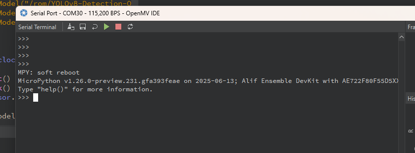

Hi,
Thank you so much for the help @kwagyeman and @iabdalkader .The micropython is working now. Just one last thing, is there any way I can run your applications, examples, etc on the devkit? As till the time your product gets launched, I will get idea of your systems working, IDE and other things.
