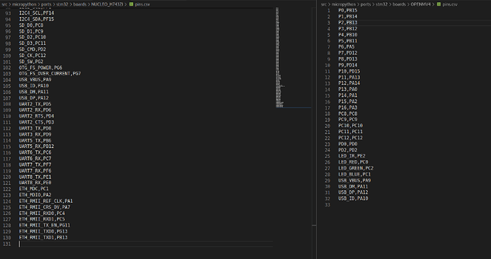

Could you foresee any reason why this could not be possible with the current firmware structure on the H7 camera with minor changes as they’ve been able to achieve it on the NUCLEO:
> <https://github.com/rf-eng/micropython/commit/e2c24910c03bd4f786d67ca4991b31df99a75044>
The pin inside the CSV file look like they can be mirrored from the nucleo as they are only allocated to generic IO pins:
 ![Screenshot from 2020-11-20 16-33-25.png](https://canada1.discourse-cdn.com/flex029/uploads/openmv1/original/2X/f/f9814e7f6ebc083cf56349e2dc3b8ac7467a6d87.png)
WIZNET5K is a goner sadly. As thought compile but the library is broken for the openmv ☹

We will be getting Ethernet working as per support for the Portenta. So, if you can wait it will be enabled. There’s is no reason we can’t get it working.

None of our boards have an eth phy so it will only be supported on the Portenta.
