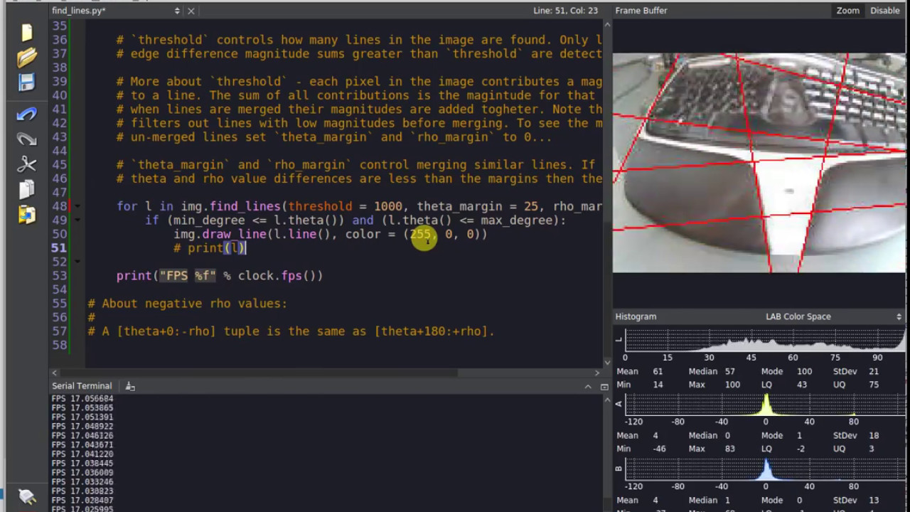

Postby jason.sjh7@gmail.com » Wed Dec 20, 2017 1:48 am
Hi Thank you for the reply!
I Just did that
./openmv-ide -open_serial_port_termnial /dev/ttyACM0:115200
https://drive.google.com/file/d/1t_GO3c ... sp=sharing
But I want to get only realtime camera frame without 'OpenmvIDE'
for example :
ex1
https://drive.google.com/file/d/10FU2kh ... sp=sharing
How can I get realtime camera frame like 'ex1' ?

Postby kwagyeman » Wed Dec 20, 2017 2:40 am
Hi, you just need to add:
print(img.compressed_for_ide())
To the end of the while loop after you script and you'll be able to see what the camera sees. To hide the text just resize the frame buffer until it's the whole window.

Postby jason.sjh7@gmail.com » Wed Dec 20, 2017 3:10 am
Thank you !
I can get camera sees after hiding the text and resizing the frame buffer.
but This does not, as I though...
I get frame ex1) , WITHOUT IDE.
Can I get camera sees , using opensource openmv-fb.py ??
